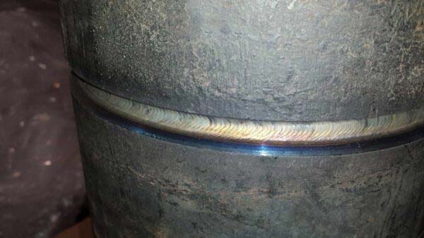

Gas Tungsten Arc Welding (GTAW) differs from other gas-shielded welding processes in that it uses a non-consumable tungsten electrode. The tip of the tungsten electrode used in GTAW welding must also be carefully ground to the correct shape, which will vary depending on the type of metal being welded. Shielding gas flows around the tungsten, and when an arc is struck, the electrode makes a very small molten puddle that remains pure and can be directed with an incredible degree of fine control.
In the hands of a skilled arc welder, GTAW welding creates very neat, precise, and reliable welds. The advantages of GTAW pipe welding include:
The advantages of GTAW arc welding make it the best way to weld pipe for those seeking quality welds. Unfortunately, the manual GTAW welding process has several disadvantages. It is difficult to master this welding process and it takes a great deal of training and experience before a welder can correctly weld GTAW. It is also a very slow process, and, as a result, manually performing deep groove or narrow groove pipe welds takes a prohibitive amount of time. Usually, if manual GTAW is used weld pipe, it is only used for the root pass - the part of the weld in actual contact with the pressurized or corrosive material in the pipe - while the rest of the groove is filled in using FCAW, GMAW, or even SMAW processes. However, developments in automation have solved many of the disadvantages of GTAW by making it possible to perform reliable GTAW welds using orbital welding.
Orbital welding is a mechanized welding process that allows the welder to program the weld controller with the weld parameters, such as the feed rate of filler material, travel speed, weld current, arc voltage, and other variables. By automating the weld procedure, orbital GTAW welding makes the process easier for the operator and provides a solution to the problem of finding qualified GTAW welders.
Automated orbital welders can be continuously wire-fed as well as autogenous. Wire feeds significantly speed up the orbital GTAW welding process for narrow groove welds and other weld types that require a great deal of filler material. Automated GTAW welding can improve welding productivity for both thick-walled pipe and pipe welding where no filler is required. Orbital GTAW machines produce high-quality welds more easily and efficiently than manual GTAW, making automated orbital GTAW welding the best way to weld pipe.
