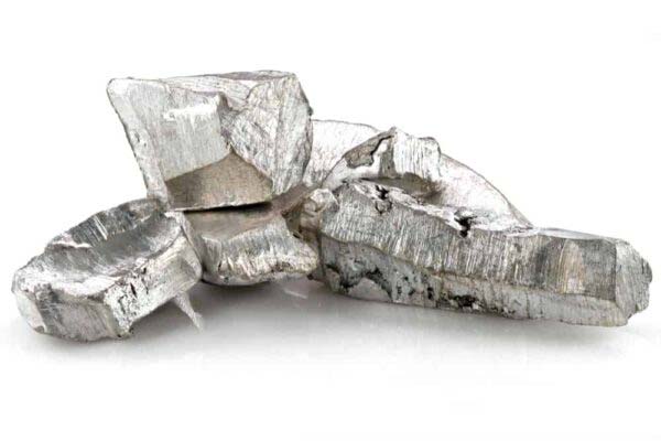

One of the most dangerous toxic elements that many welders will encounter during their careers is cadmium. In fact, according to OSHA, overexposure to cadmium has resulted in several fatalities due to its extreme toxicity. Fortunately, welding process and equipment advances have been developed that, if implemented, can help mitigate the dangers of working with this element.

As the above list indicates, cadmium is valued in a number of products and industrial processes despite the hazards it poses for those who become exposed. As with other potentially harmful substances, the primary threat from cadmium in welding is from exposure to toxic fumes while welding black iron and steel piping.
Some product uses of cadmium are being replaced by newer technology; for example, the proliferation of Li-ion to replace Ni-Cd batteries. This is not true for welding, as cadmium is used in the processing of steel alloys, as well as filler material. Therefore, it is important to understand the risks associated with cadmium.
It is well-known that cadmium exposure can cause cancer. The element may attack various systems in the body, as listed below.
