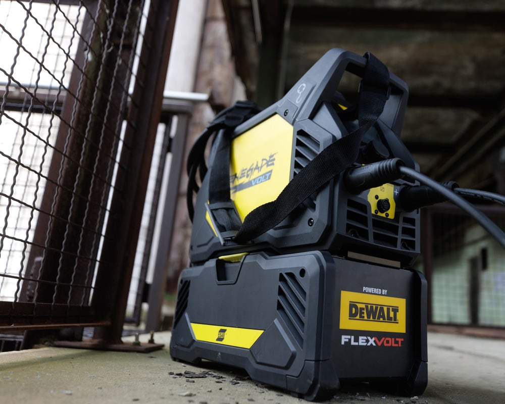

ESAB’s Renegade VOLT™ ES 200i uses DEWALT® FLEXVOLT® batteries. This collaboration ensures that ESAB welders benefit from high-capacity batteries designed for maximum power and efficiency. The FLEXVOLT® batteries enhance the functionality of the Renegade VOLT™, providing the necessary power for demanding welding applications.
The battery life of a battery-powered welder varies based on the model and the type of welding performed. Generally, you can expect several hours of continuous use from a single charge. For the Renegade VOLT™ ES 200i, you can weld up to 33 electrodes in stick mode or operate for up to 50 minutes in TIG mode at 70 amps before needing a recharge.

Operating a battery-powered welder is generally straightforward. To use one, you typically connect the battery box to the welder, which then automatically switches to battery mode. This simplicity is a significant advantage of battery-powered welders, as it reduces setup time and allows you to start your tasks quickly and efficiently.

Battery-powered welders are designed with efficient charging capabilities. Most modern models come with fast chargers that can fully charge the batteries in about 1.5 to 2 hours. This quick charging time helps minimize downtime and allows you to return to work promptly.
Efficient charging is an important feature that contributes to the overall convenience of using battery-powered welders, making them a practical choice for a variety of welding tasks.
Renegade VOLT™ ES 200i comes with a DeWalt fast charger that can fully charge the batteries in approximately 120 minutes. This quick charging capability minimizes downtime and ensures that you have a readily available power source for your welding tasks.
