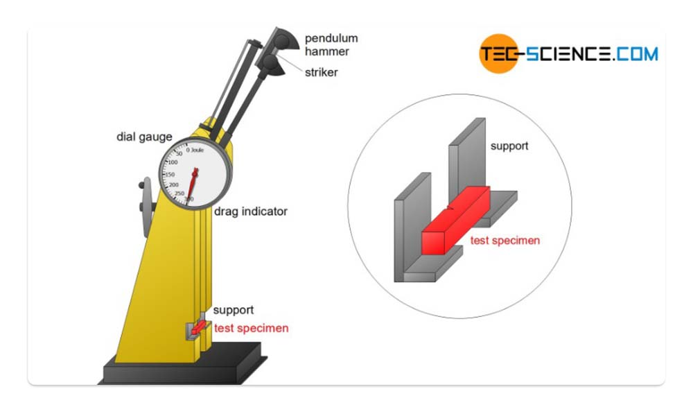

At the heart of the Charpy test is the Charpy Impact Testing Machine. During the test, a pendulum arm is raised to a predetermined height and then released to strike the specimen with precision. The energy absorbed during the specimen's fracture is quantified in joules (J) or foot-pounds (ft-lbs.). Engineers leverage this numerical reading to compare materials, aiding in material selection and ensuring quality in welding and other industries.

Rectangular Specimens: Cut from the welded material, these specimens typically feature a V-notch machined into them, with standardized dimensions based on testing criteria.
V-Notch Orientation: The V-notch is strategically positioned to target critical areas, often in the heat-affected zone (HAZ). Its orientation may vary depending on specific requirements and norms.
