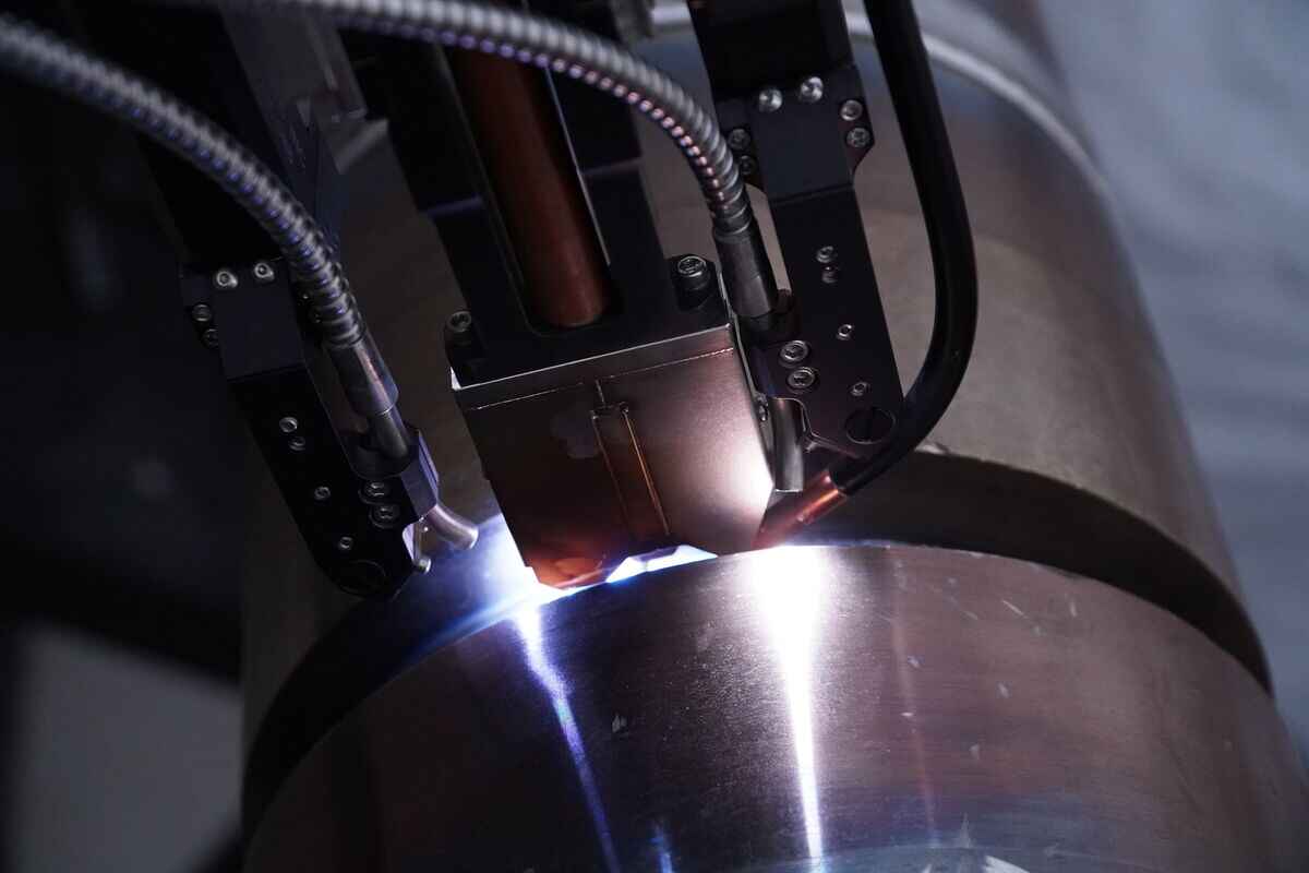

Unlike conventional TIG welding, where results depend heavily on operator skill, orbital welding uses mechanized weld heads to rotate the electrode around stationary tubing, pipes, or cylindrical components in a precisely controlled 360° motion. This level of automation eliminates variability and ensures welds meet or exceed specifications for industries such as aerospace, biopharmaceuticals, nuclear, semiconductors, and food and beverage.
For manufacturers working with sensitive alloys, sanitary process systems, or high-pressure pipelines, orbital welding delivers a decisive competitive advantage: defect-free welds with high reproducibility, reduced rework, and optimized productivity. For a deeper dive into how orbital TIG systems function, see our guide on the Orbital TIG Welding System (AMI).
Orbital welding is a specialized form of GTAW/TIG in which the electrode and arc orbit around a fixed workpiece, typically tubing or piping with diameters ranging from 1.6 mm (1/16 in.) to 152 mm (6 in.) and beyond. The process is most often used with stainless steels, titanium, nickel alloys, and other high-performance metals where contamination or inconsistencies could compromise system performance.
