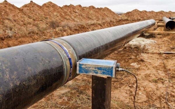

The best welding for pipeline applications is orbital GTAW welding that can easily pass radiographic and x-ray testing.

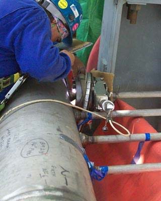

Orbital TIG welding is used to weld oil refinery piping.
Orbital welding was developed as a way to address the difficulties of training welders on manual GTAW and of regulating the speed, angle, and travel issues that can arise during TIG welding.
Orbital welding automates travel speed, electrode angle, gas flow, arc length, filler input, and other aspects of the welding process according to settings entered into the control unit. This gives orbital welding the following advantages over manual TIG welding:
  • Accessibility: Orbital welding needs only enough space around the pipe for the weld head to be mounted. This is considerably less than what is needed for a manual welder to maneuver their whole body, and allows pipes in obstructed areas to be welded without disassembly or the removal of surrounding objects.
  • Speed/Productivity: Using an orbital welding system, a welder can complete a single pass on a pipe joint without stopping. A manual TIG welder, on the other hand, typically breaks the circumference of the pipe into sections, with setup and prep time required for each section. Also, automated orbital pipe welding weld head has a higher and more consistent deposition rate than manual TIG welding. As a result, a trained orbital welder can easily outperform a manual TIG welder.
  • Consistency: The travel speed, electrode angle, gas coverage, and movement pattern of a manual welder are subject to inconsistencies due to the welder’s skill level, positioning, access to the weld joint, and level of fatigue. The automation of the orbital welding process results in a weldment of uniform consistency with less chance of contamination or occlusions that might weaken the weld.
  • Control: Many orbital welding setups can be used in conjunction with data acquisition systems so the operator can monitor—and even record—the weld in order to ensure that the joint is being welded to specification at all times. This stands in sharp contrast to manual TIG welding, in which the welder can only monitor puddle shape and weld formation, and would not notice the loss of shielding gas or contamination until after the weld was completed.

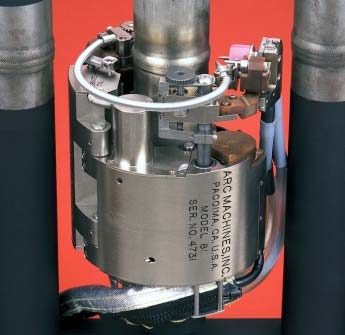

A compact, low-profile orbital weld head can weld pipelines in cramped conditions.
The best welding machine for your pipeline application depends on the diameter of the pipe being welded, as well as your unique work environment. The following types of weld head can be adapted to suit almost any pipeline project:
  • Low-profile, small-diameter weld heads work with pipe diameters from around two inches in diameter to more than five inches in diameter, with less than two inches of clearance needed around the pipe for mounting the weld head.
  • Full-function weld heads can accommodate an even wider variety of pipe diameters (from three-eighths of an inch up) and are compatible with a wide variety of metals, from common carbon and stainless steels to common non-ferrous metals like aluminum, and even exotic alloys like Hastelloy®, Inconel®, and Monel®.
  • Heavy-duty track-mounted weld heads can handle pipe of any diameter larger than three inches. With cross-seam steering of up to 12 inches, high-quality heavy-duty weld heads can handle very wide passes.
