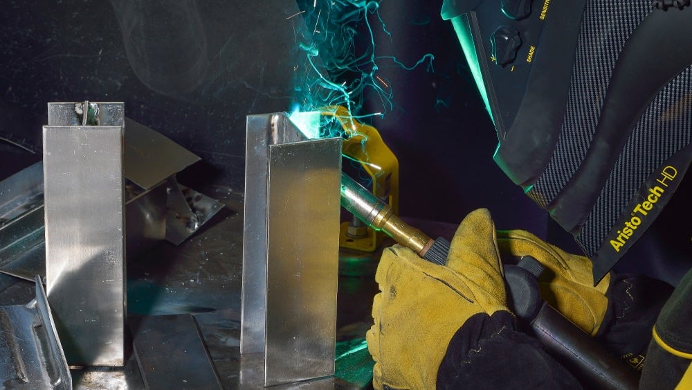

Aluminum naturally forms an oxide layer immediately upon exposure to air. This layer melts at approximately 3,600°F, while aluminum melts at only 1,200°F, depending on the alloy. If not removed or disrupted, this oxide can interfere with puddle formation and lead to weld defects.

Skipping prep might save minutes, but it increases the risk of flaws like:
In structural or high-load applications, these flaws could lead to catastrophic failure. Whether you're TIG welding or MIG welding aluminum, cleaning and prepping properly is one of the most effective ways to ensure safe, sound welds.
