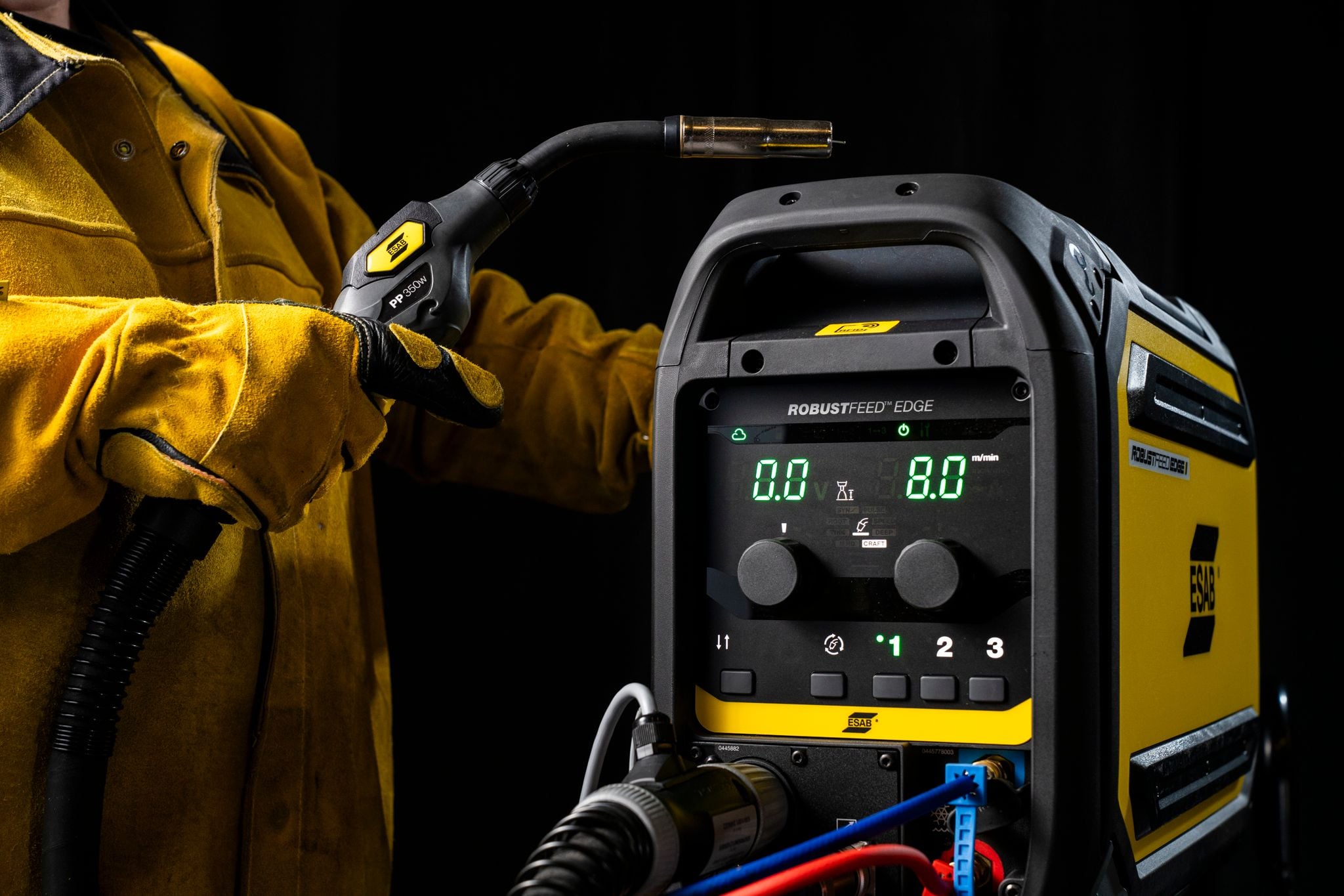

    RobustFeedEdgeAluminum
    ESAB’s new Warrior Edge DC industrial aluminum system features the ESAB PP 350w push-pull MIG gun and new Craft Mode for reduced heat input and a TIG-like bead appearance.
