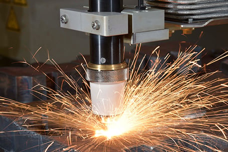

    SmartJet Green Piercing
    "ESAB’s SmartJet Greet hydrogen cutting technology offers faster piercing, equivalent cutting performance and lower costs compared to cutting with hydrocarbon-based fuel gases."
    Hydrogen cutting has a distinct advantage for cut starts and piercing regardless of plate thickness. According to Zlotnicki, a good table operator can preheat a plate in 20 to 30 seconds with oxy-acetylene. Using SmartJet Green technology reduces preheat time to 5 to 10 seconds because the focused hydrogen flame heats a specific point (which also the mitigates the risk of excessive overheating). The SmartJet Green torch can pierce steel up 150 mm (6 in.) and edge start on steel up to 300 mm (12-in.).
