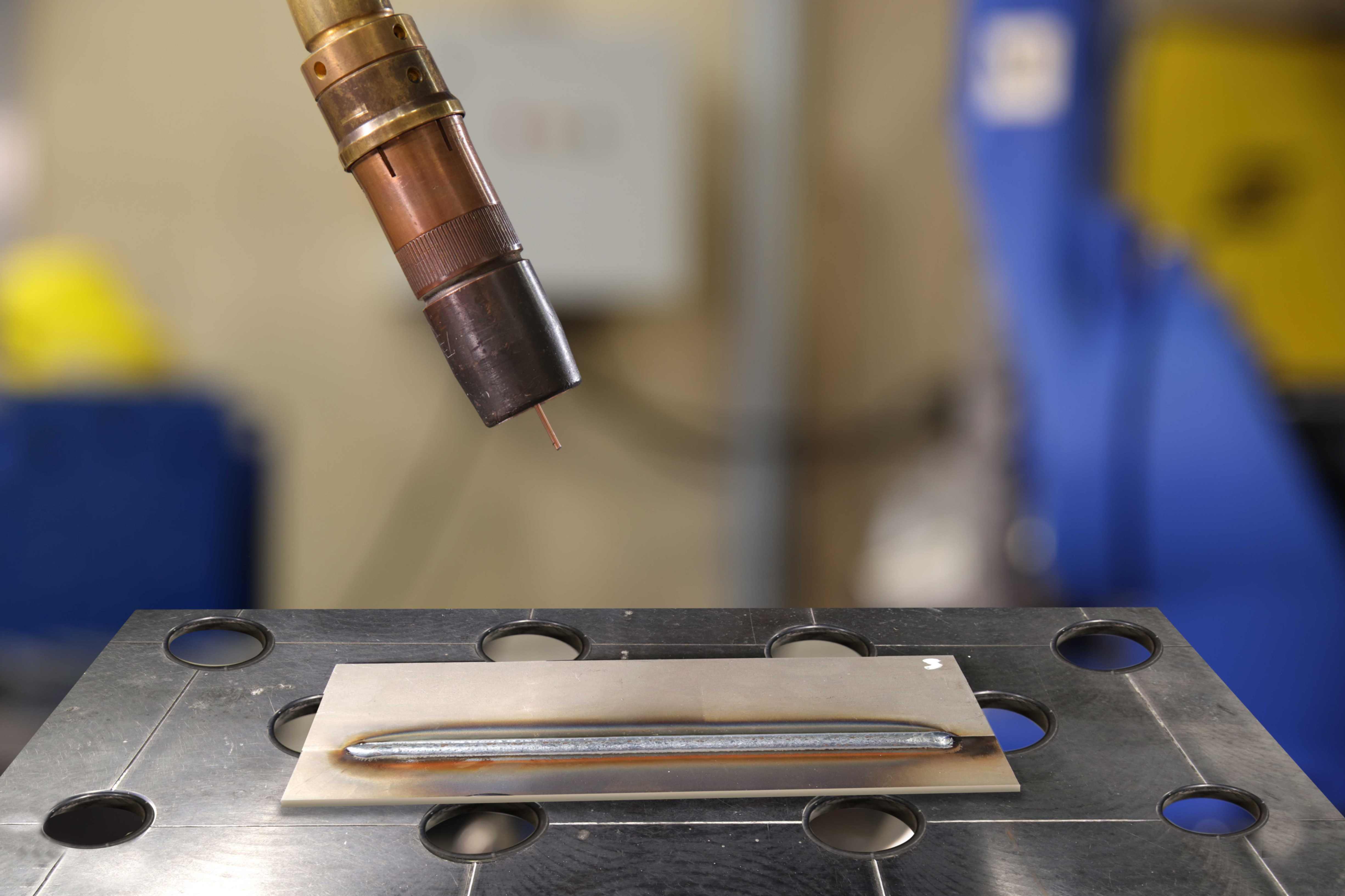

    Robotic torch_Action Photo
    ESAB’s new OK Autrod 42 LSW is a copper coated ER70S-9 solid wire engineered to minimize slag and silica islands on the weld bead to reduce cleaning and the total cost of welding.
