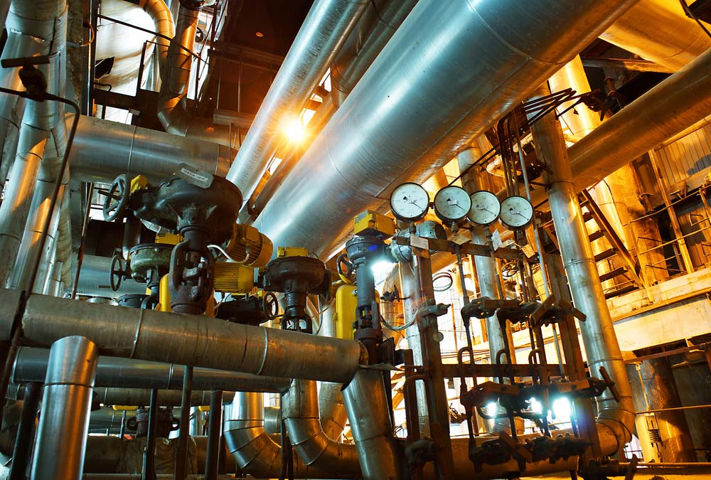

Many crucial industries including oil and gas, biopharma, and food and beverage, rely on the elaborate networks of pipe or tube systems to ensure a continuous supply of material while enduring high temperature and pressure conditions. The demand for high standards from the pipe and tube system means their fabrication has to be done precisely and consistently to uphold the metallurgical properties of the high-quality metal being used.
