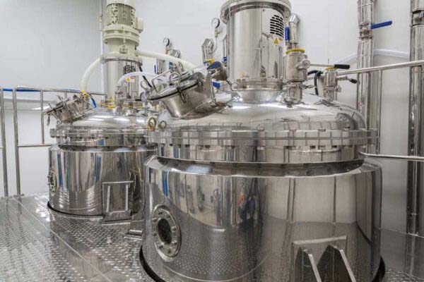

Of the accidents mentioned above, the guacamole maker is likely to have been built following more stringent requirements. It would have been designed and constructed to keep the food inside free of industrial contaminants as well as to contain pressures. This would have limited the welding processes that could be used to those processes whose final welds can meet sanitary requirements for food. The biopharmaceutical industry and the semiconductor industry have similar cleanliness requirements that limit the types of welding used in pressure vessels built for those industries.

Of the types of welding used in pressure vessels, the one chosen for a specific project should suit the needs of the product the pressure vessel will store or produce and the pressure that the product will be kept at. In the oil industry, pressure vessels are kept at relatively low pressure, and while corrosion can be an issue, sanitary considerations are not. As a result, quicker and more expedient processes like SMAW and FCAW are frequently used.
In higher specification projects with higher pressures, welding processes that render more consistent results, like GMAW or SMAW, are more likely to be used. In industries where both pressure and sanitation are a major concern, the root pass—which will be in contact with the product—is very likely to be welded using GTAW, as it provides a far cleaner and smoother weld than any other type of welding. Given the amount of welding that a pressure vessel requires, however, this is likely to be quite time-consuming if done manually. Mechanized welding processes like orbital welding can help increase the speed of GTAW welding used in pressure vessels.
Orbital welding was developed due to the need to create high-quality welds on hydraulic and aviation tubing for aerospace projects. The cylindrical nature of these welds posed a challenge for manual welders, and the changes in pressure as planes changed altitude tended to cause leaks. Orbital GTAW successfully produced high-quality welds that maintained integrity through these intense pressure changes. In the time since, it has been used to create equally high-quality welds in process piping and pressure vessels for the petroleum, biopharmaceutical, semiconductor and other industries.
Orbital welding is just one of many types of welding used in pressure vessels, but it is by far the best choice for welding pressure vessels with a high requirement for cleanliness and strength. The biopharmaceutical and semiconductor industries provide two examples of applications that could benefit from the consistency and hygiene of orbital welding. As the requirements for manufacturing products become more stringent and public and regulatory bodies become even less tolerant of accidents, the value of GTAW orbital welding in pressure vessel construction will only grow.
