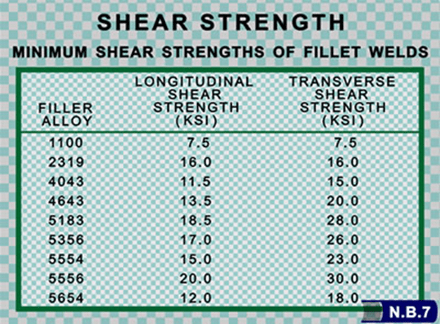

When the filler alloy selection chart allows the use of either 4043 or 5356 as filler for a specific base alloy, as a guide, we may wish to consider the following facts about each of these filler alloys.
Fig 1. Shows the typical shear strengths of various filler alloys, as can be seen, 4043 has 15ksi in transverse shear and 5356 has 26ksi when loaded in the same transverse direction.
It is wise to use the filler alloy selection chart to assist in selecting the most appropriate filler alloy to be used. It is also wise to conduct procedure qualification testing to evaluate the filler alloy selected to verify its performance characteristics.
