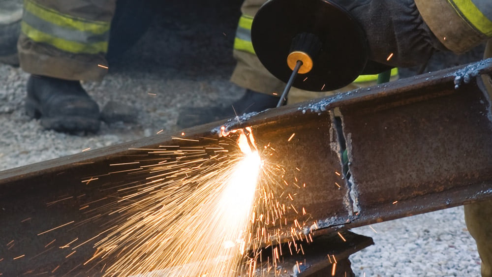

Exothermic cutting procedure varies based on the job. The standard process for exothermic cutting is done by a drag technique. When the rod is in contact with the piece to be cut, the rod is dragged in the direction of the cut.
When piercing surfaces, you need to follow certain procedures to ensure safety and a high-quality finish. The use of a collet extension helps add life to the torch. Using a hand shield improves operator safety and comfort. Make sure to wear PPE to protect yourself from the heat, fumes, and sparks generated from cutting. Always hold the torch at an arm’s length. To prevent the cutting rod from getting trapped inside the pierced hole, remove the cutting rod from the hole before you release the oxygen lever.
