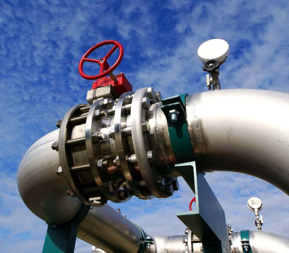

Consider oil and gas pipelines: most use carbon steel. Their operating conditions, however, can expose pipelines to harsh chemicals and environments that may adversely affect carbon steel. Stainless steel cladding adds a thin layer of stainless steel over the carbon steel surface to increase its durability. Further advantages of stainless steel cladding include:
With many stainless steel types to choose from, cladding is possible for an array of unique applications. Because it enhances strength and provides the highest resistance against corrosion (due to its ferrite and austenite composition), duplex stainless steel is commonly used—especially when cladding pressure vessels and tanks. Common stainless steel grades, such as 304 and 316, can be used to clad components that are used outdoors.
There are several ways to perform stainless steel cladding, including hot roll bonding, cold roll bonding, explosive bonding, welding, and more. Hot roll bonding is a commonly used method where the plates of the base metal are placed on or between the plates of the stainless steel cladding layer.
The weld cladding process is another effective method. When welding, a layer of stainless steel is deposited over the carbon steel surface in single or multiple passes. GTAW or GMAW is popular with this method; the choice of weld process depends on factors like material use, accessibility, weld positioning, and cost-effectiveness.
